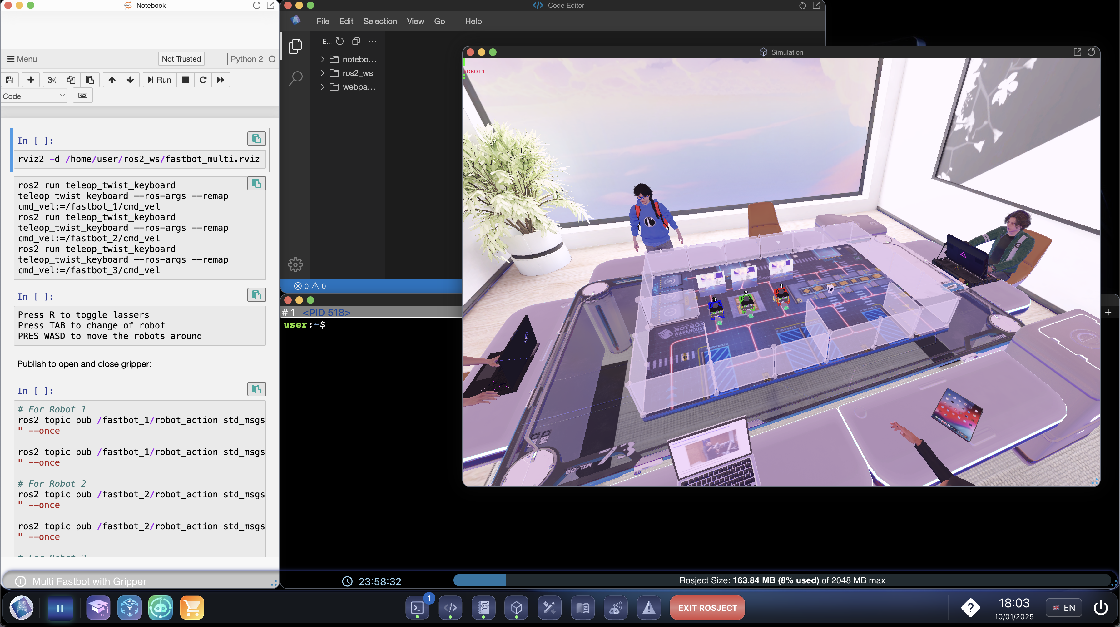

How to launch a rosject
  • To open a rosject, students select the rosject on the My rosjects section and click on the Open rosject button
  • The notebook with instructions, the IDE, the terminals and the simulation will open
  • Now the student can work on the rosject

If you have those two things done, then do the following: 1. Click on the icon at the bottom
  1. Click on the Connect green button of the robot you want to connect to
From that point, the terminals will be ROS connected to the robot of the lab. So now, every ROS command executed will be applied over the ROS topics of the robot.
IMPORTANT
The program executed on the cloud computer is actually executed in the real robot!
