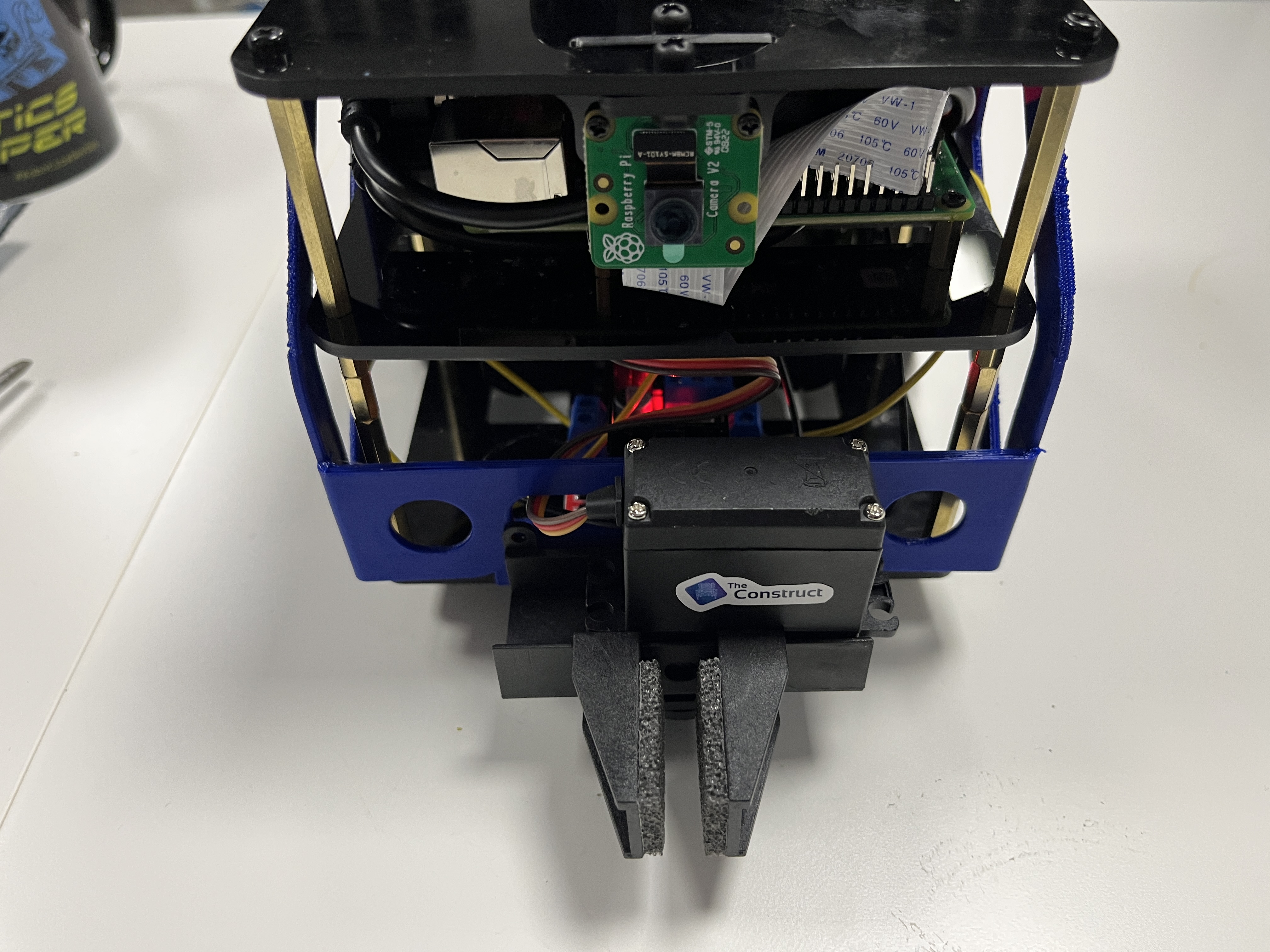

This is a gripper that needs callibration

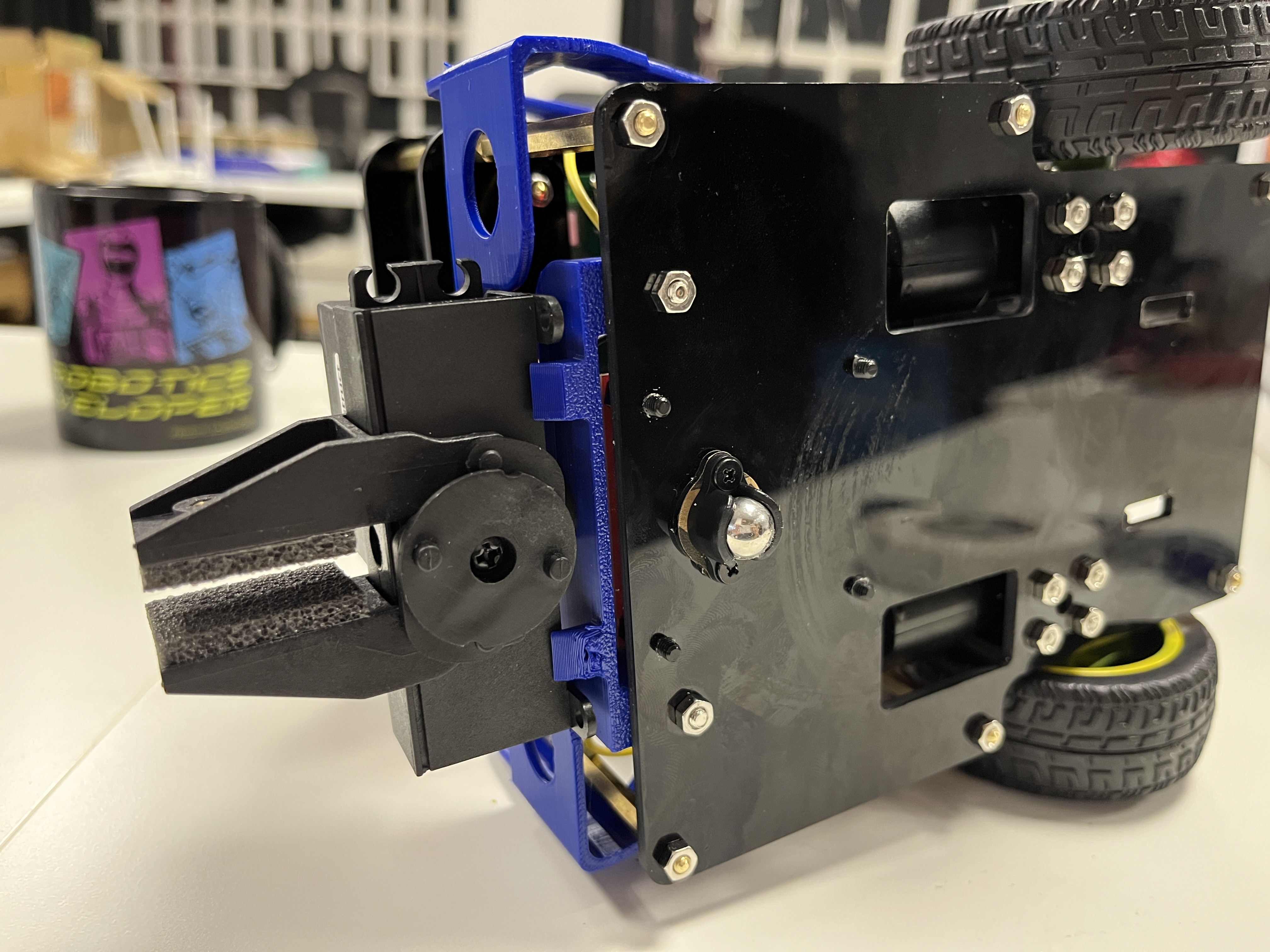

Turn it upside down

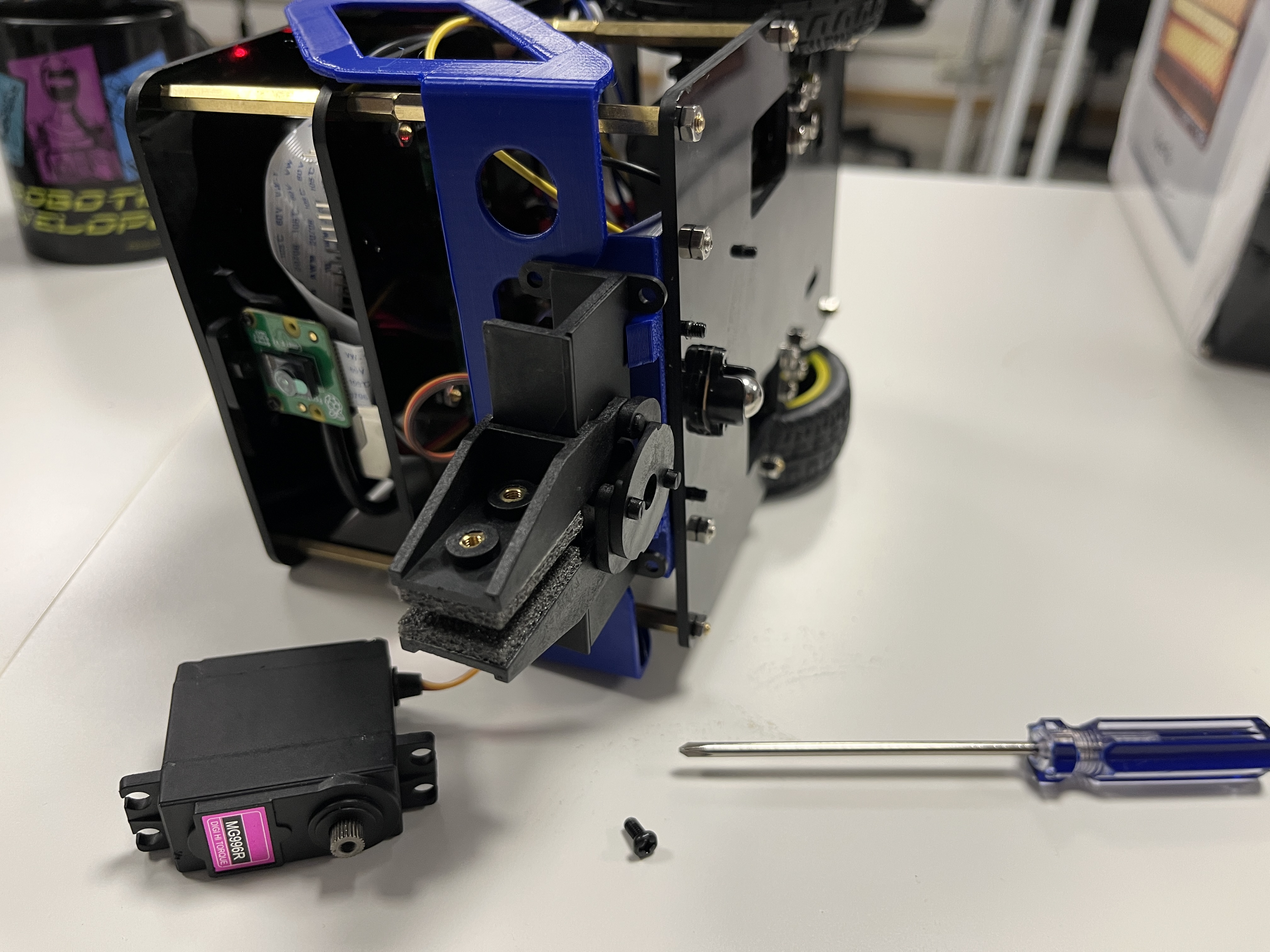

Remove the screw and the motor

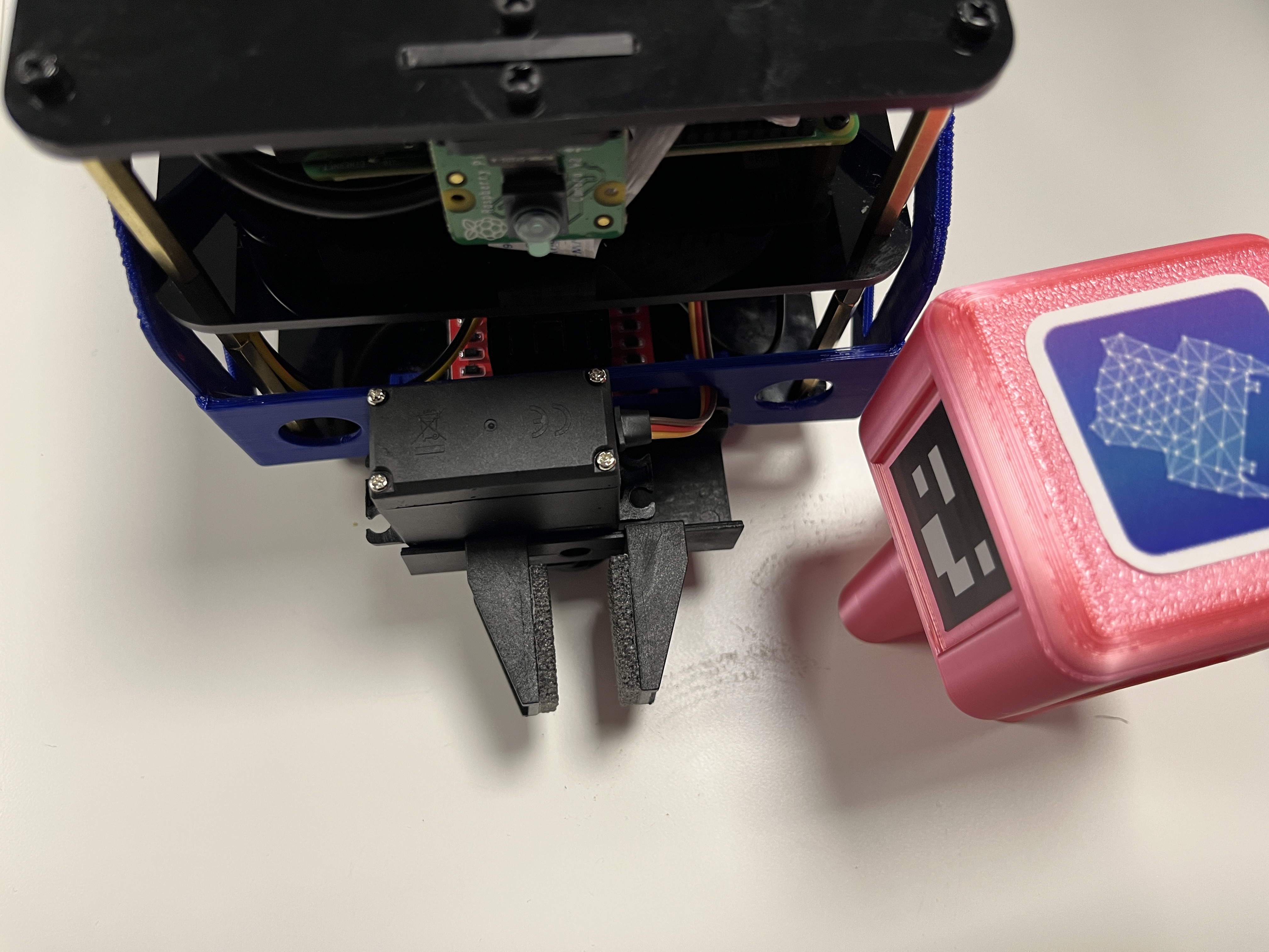

Put the cube between the gripper fingers and close it as much as possible:

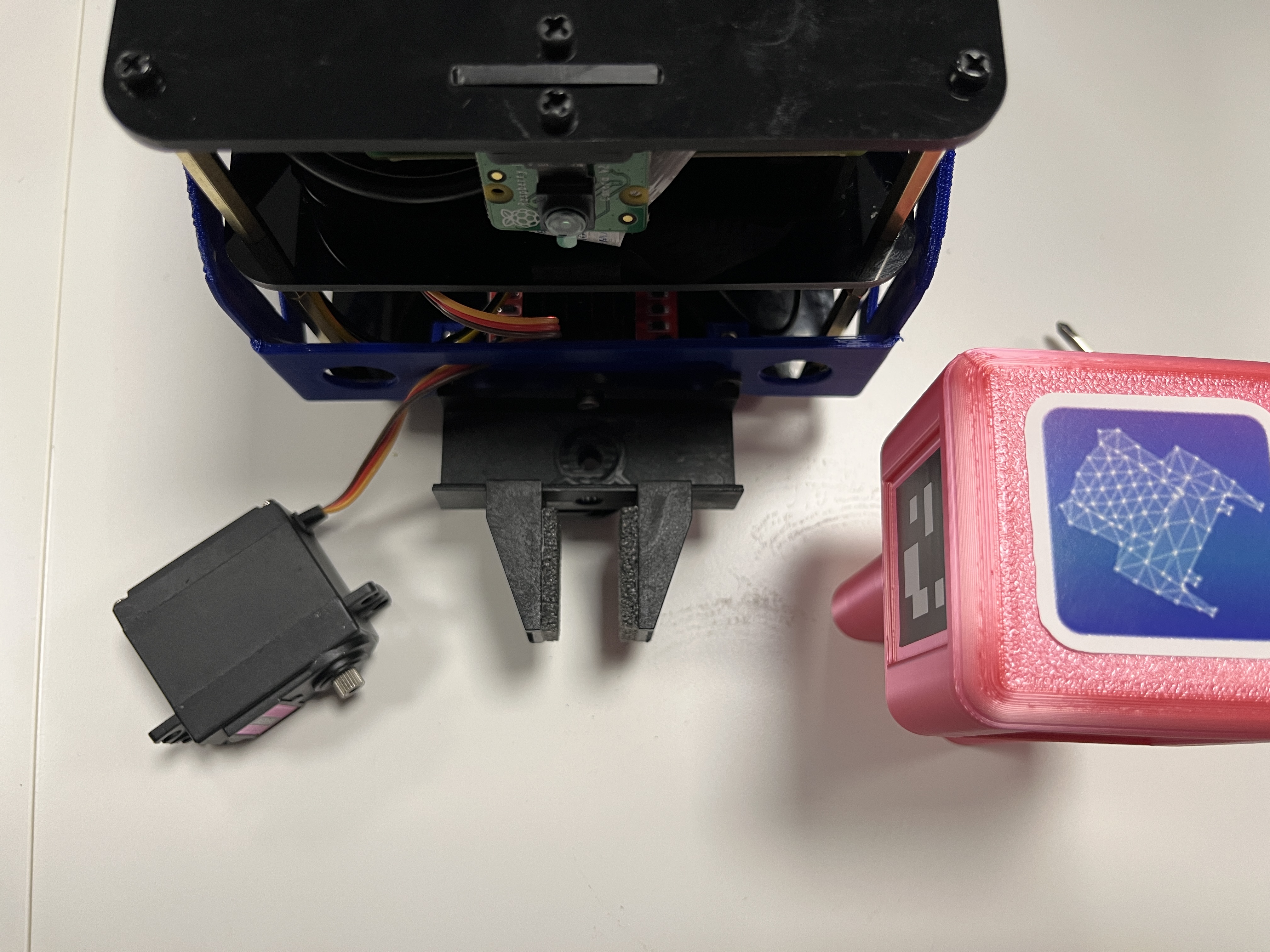

Remove the cube from the gripper and close just a little bit more the gripper fingers. Then connect to the robot by ssh and then send the command:
ros2 action send_goal /fastbot_1/gripper
Finally, screw back the motor on the top of the gripper
